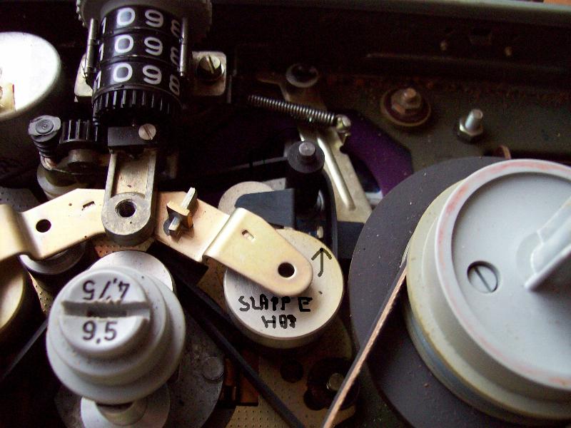

Someone I knew bought a taperecorder on a fleamarket, because it was a so beautiful design that It was hard to resist. At home he could not find the mains cable and opened it. But he is not a good technician so he sold the thing to me for the original 3 euro's.
What are we doing
Picture 2
1 Something was connected here
2 I do not trust that cable, lets open up the other site
3 some rests of old styrofoam
picture 3
Ah there you are ...... and some styrofoam again
Picture 4
A snare so loose , that cannot be true with this width
It flips off so easily
The noisy sound when shaking te recorder is caused by two
restant parts of the handle, what a #$%^& who cut that off
Look to that wheel on the right, it has no function so.
The speed regulator, something bad happend there. One of the owners who tried to repair mixed up the snares
now you have one speed for playing and 2 for winding
:roll::roll:
No wonder that the main wheel not turns properly, by mixing up the snares, this one is certainly to low mounted underneath in stead of on the wheel.
Firts thing mounted is the wheel without a function. It solves the loose snare.
With this crappy picture, a motion is simulated
not on purpose. I hope it wil work now and that I do not have troubles with the electronics, becoming parts is so difficult.
And now ..........
Playing time
Bad quality by sticky messy BASF tape, but it was the one on the machine. It is recorded in a church. Some religion you can not avoid. But the machine is working .
